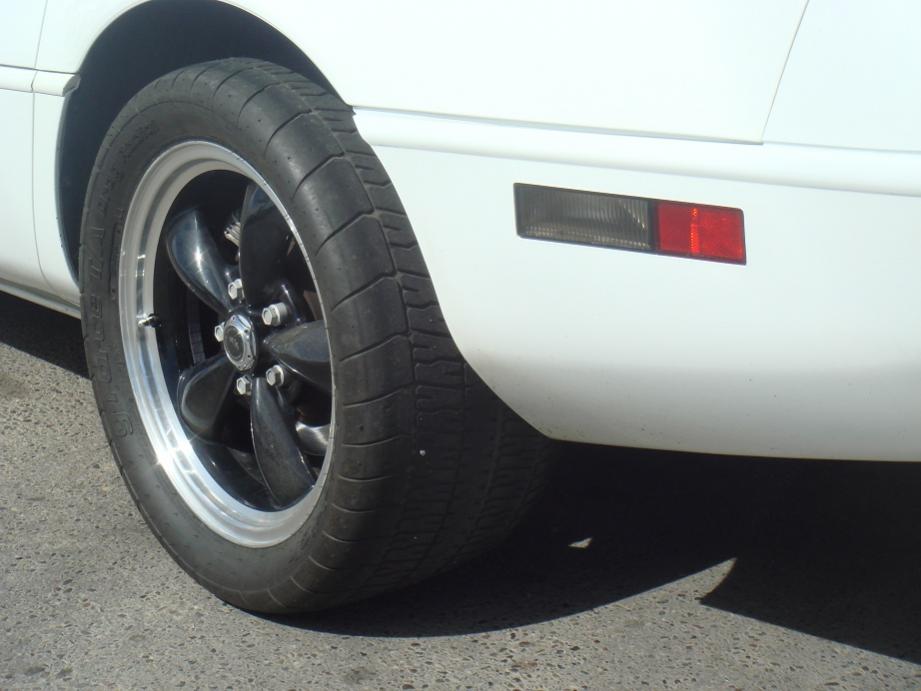

I know that it is highly suggested to not run 315/35Z17's on stock 9.5 rims, but why ? In my searchs I see most say to not run this combo, but I have my drag 315/35Z17 radials on a aftemarket 9.5 rim, and after 20 passes on them at 17 - 22 psi, no issues.
is it because of wandering or what?:confused:confused:confused
I attached pics of my drag setup, but at 30 psi on the way home today after the races.
