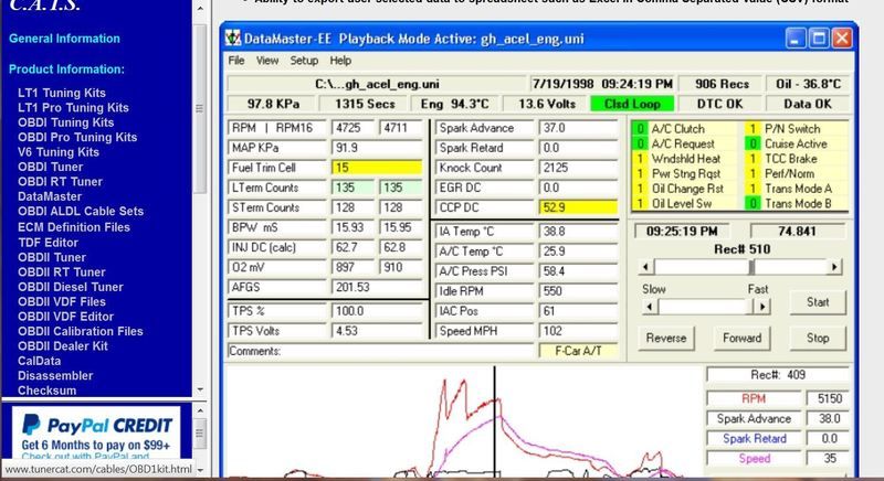

You need to use a scanning software program to monitor the engine sensors in real time. The program will allow you to save the data and play it back so when the surging occurs you can see what the value of each sensor was.
Go to TunerCat
Look at the Datamaster scanning software package.

Here's a screen shot of the DataMaster software. It can display O2 sensor signals, throttle position voltage, engine temp sensor voltage, MAF and Map signals, engine rpm etc.....
