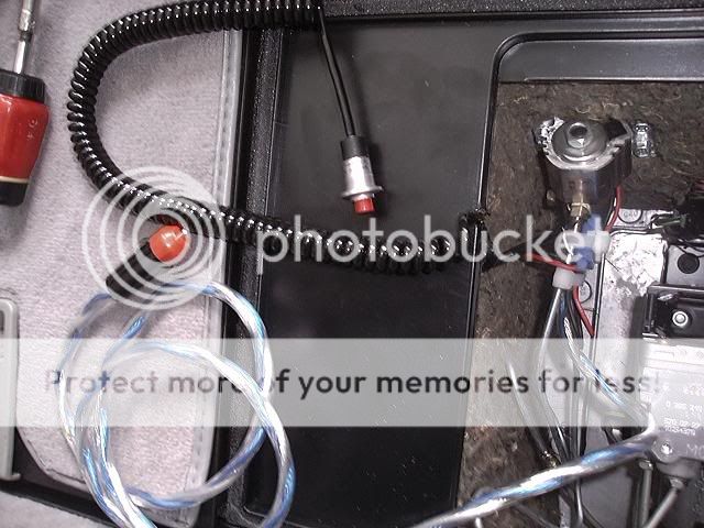

Refer to your manual to tell you which port on the line lock is the inlet. Mine was a Hurst unit so yours should be on top same as mine.

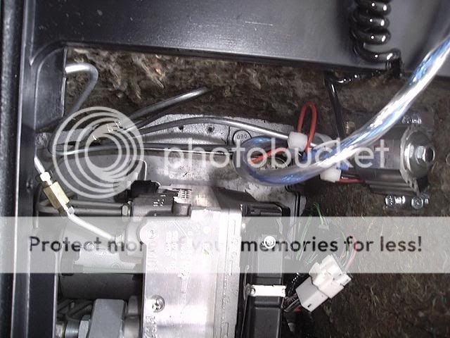

In this image you can see the bottom line in the picture closest to the floor coming from the master cylinder. On the ABS unit the two bottommost lines go to the left and right front brakes. The ABS unit should be labeled MC1 for the front and MC2 for the rears. The rear brakes will have a larger diameter hard brake line running to them.
This next picture shows the line from the master cylinder running to a coupler after cutting the existing line and putting on a standard fitting. The coupler joins the existing line and a new line running to the top of the line lock solenoid. Exiting the bottom of the solenoid is a new line running to a coupler and then joining to the existing line by means of a standard fitting. When you cut the line you should cut it at the top of the bend so as to leave enough line to put on your fitting and double flare the lines. on the ABS unit there are only metric fittings so you will need to keep that small portion of line with the metric one and put a standard on the other end and flare the line. Be extremely careful when bending your lines.
Tools you will need.
Switch to activate and cord for power from cig lighter.
Stealth install, when the lid is closed you will never know it is there.
