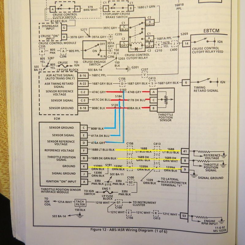

ecss Had the car on a battery maintainer all winter. If I press the brake the ASR active light goes out but if I hold the brake on and tap the gas the pump does not growl, the light stays out, but the pedal pushes back. Also noticed when I start the car the idle is rough then clears up when I turn the ASR off. Don't know if it's trying to cut the timing back at idle or what. Should have noticed that before but was concentrating more on the light and gas pedal.
The service manual does mention the EBTCM receives a buffered TPS voltage.
If the throttle body or TPS is replaced or removed you need to use a Tech 1 diagnostic program to update the EBTCM TPS voltage. I know you said you never messed with them but could be over the winter some how the correct voltage was lost? :ugh
I have a Tech 1 you can borrow so you can run the TP Sensor Learn procedure and also run the ASR test with the rear wheels off the ground.
