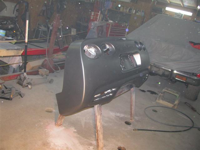

I'm in the middle of trying to match the paint on my ride after some No English Speaking,No Insurance Cell Phone Talking Winch rammed me in the A$$ at a stop light!
:hb
I'll try to dig up pertinent ground locations for cruse and radio when I get this paint thing Whipped!~!!:thumb
