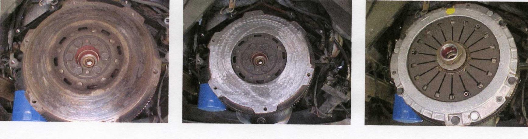

Here are pictures that the repair-shop made of my flywheel before and after resurfacing...
So what did they use to resurface it,a 2 1/2 inch body grinder with a 16 grit rolock disc???My guess is THATS your Noise!~!! Buy a NEW DM Flywheel,I'll bet your noise will be gone!~!!:thumb:thumb:thumb
A properly re-machined flywheel will have a surface that looks more like the photo below!~!
I was thinkin 4" paint stripper wheel is what they used....or the edge of the 4" cut off wheel !
Holy Crap, that's worlds away from the picture I posted. :ugh When they said that they refinished the flywheel I never second guessed them.
