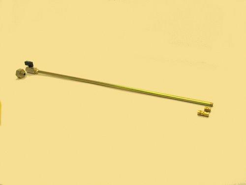

If you think your radiator has a blockage, you might want to simply try Thexton tool, 467A, which is a wand that flushes water through the radiator or condensor with a 90 degree fan spray. The picture is below.
Personally, inspection and correct diagnostics is critical to evaluating a correct system repair or determination IF there is something wrong.
