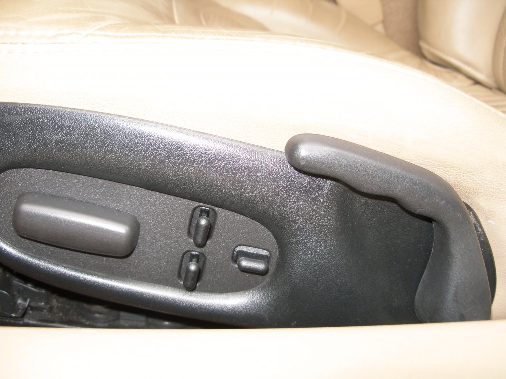

i did the deed on my drivers seat, I have not read the entire post but I assume your question is about the seat repair. Here's what happened on my end, I did the repair not too long ago:
small hands and patience helps on the electrical connections, the Ms helped. I did not determine if the seat mounting nuts have a torque....I just tightened them down. You have to be careful with the 3m glue...off your hands, wear a mask and eye protection, I held my breath any way and left the area to breathe, spray in the proper place and do a dry run on how you place the ballistic mat...if the mat touches the glue, it stays! Prepare a nice area to work on the seat, I put out some horses and plywood sheeting. Might as well clean the covers while the seat is out of the car. I could not find the small size bull rings to set the cover back on the seat but the next? Size up was okay, now have a new tool, bull ring pliers!! If the button eschucheon is broken buy a new one....I found two broken areas on mine. I put the jute? Pad on mine, the seat feels great now, what an improvement. Oh yes, I also placed some ballistic type material on the L edge of the seat...the metal also cut into the seat bottom foam, again with the fantastic ! Glue. An easy way we removed the seat back handle: We used a 2" long needle ( needle thin) nose pliers ....the nose of each end was pressed against the tips of the C clip and off came the handle, easy peasy. As far as I know there is no fix for the seat back that pops out of place if your back presses hard against it while adjusting your man stuff. The seat back handle pops the seat back in place. I am really pleased with the outcome of project.
