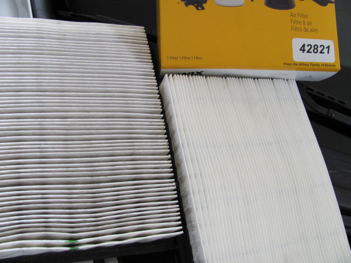

While I was changing the air filters on the C6 I got a bit of a surprise. The old and the new filters were constructed differently. The one on the left (old) is Purolator A35591, the other (new) is WIX 42821. Not sure which way to have the vanes located to air flow for best filter/flow results so thought I'd ask for opinions.
For those of you that are not familiar with the C6 breather the air would be flowing towards the middle from both the top and the bottom of filters as positioned in this picture.

Since the airflow is straight thru, the pleat direction change will be negligible.
EDIT~ Sorry, I thought it was the cabin filter.
For those not familiar with the C6 breather the air would be flowing towards the middle from both the top and the bottom of filters as positioned in the picture. That would require a 90 degree turn from both air flow directions. How do you get a straight through air flow from that? One would have the air rippling over the pleats and the other one would be flowing into the creases. It looks to me as though a straight through air flow can not happen, what am I missing here? :confused :confused

You're correct on your filter, they changed to a bigger single unit in '08 and they also bumped the price up to about $90. The pair for my '05 was $19. They also changed the part numbers on those used in the '05 through '07 three times. When I purchased my first set they were different and carried the same number.
