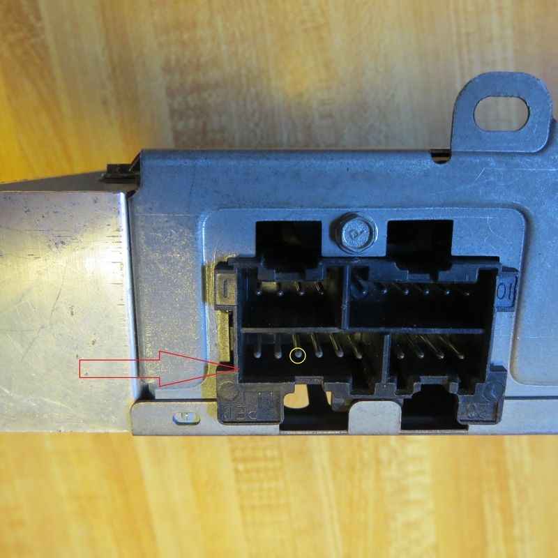

The plugs are still in the edm. whoever installed the aftermarket radio must have wired through these. The amplified original speakers were replaced. Not sure why the plugs are still in the edm. will attempt to have the radio on, and then disconnect the plugs from the edm. if this works then I will run a line from the blue and white wire on the aftermarket radio to the pink wire location at the edm location. currently I have tried to attach a wire from the blue and white to the pink wire in the original plug, still located behind the new radio. will update after I try this. casey
I did as I stated above. The radio working with all but the six pin terminal installed. the six pin terminal on the edm where there are four terminal is open, nothing installed, six pins are visible. When I disconnect the other three, the speakers are no longer powered up. at this point I attached a wire from the blue and white wire from the aftermarket radio to the pink wire still in the edm. Wire from the aftermarket is hot, the antenna did not work and the speakers did not respond. by placing the plug back in the edm the radio speakers responded but the antenna still did not respond. So I have tried about all I can unless there is some way to test the antenna motor to assure it works. Is there a fuse on the antenna line? Not sure if we can share our phone numbers, but if we could I will give it to you. thanks, Casey
