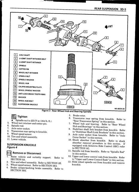

That would be #48 in my illustration, GM calls it a washer but it's more like a spacer!! Never seen one that was anything but steel!![]()
I think he is possible referring to item 11 in this blow up.otfl
They are often refered to as being Teflon on the other C4 Forums but the ones on my '87 were steelGM calls it a washer but it's more like a spacer!! Never seen one that was anything but steel!

So are the ones on my 89 steel too? and i cant find them at any parts stores around here is that something i would get from gm dealer?
My understanding from this very informative thread is when changing the rear wheel hubs, install a new washer (GM sourced 14076924), new seal (NAPA sourced 21953), replace the half shaft u-joints, and clean and apply anti sieze to the splines.
I've never ever changed any of the washers ever that I can remember,I've changed the spindle nut a few times because I didn't like the way it looked!!
The "washer" I got when I did mine was just a piece of stamped steel, no coating. Its really just a spacer between the spindle and the hub assembly.
Nope mine didn't look like that at all. They "might" have had a clear zinc coating (been a while, but they were definitely silver), but unquestionably were not teflon coated.
A zinc coating would make sense to prevent oxidation...but teflon coating really wouldn't make any sense (yeah I know that doesn't mean much :L ). Maybe that's just a zinc coating and they used various colors depending on what was available? (not uncommon)
