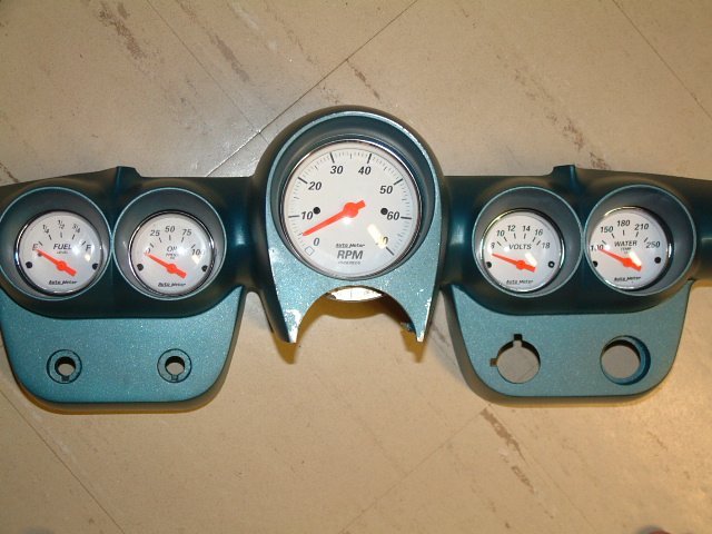

Here is a picture of an Autometer Tach in a '59 gauge pod. Gauges in this picture are mounted from the rear. I ended up mounting the gauges from the front because of interference at the rear of the fuel gauge. Should be no problem with just the tach.
very nice looking gage setup and good info. Thanks.
