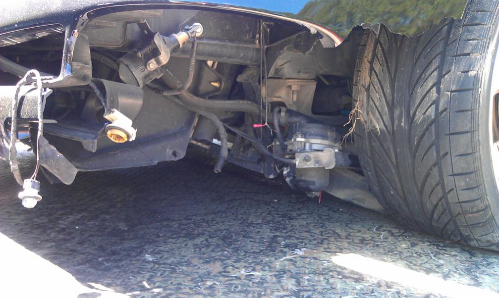

I'd tell'um to check out your bell housing real good,It's probly cracked!~!!
I've changed out 2 that were cracked around the 5 bolts at the torque tube after a minor crash!Hard to see too,if some of the bolts are loose,It's cracked!~!!![]()
Curious more than anything: how much of an impact is necessary to crack the bell housing? Is it caused by direct impact on the housing (e.g., the tire that "Rain" ran over), or can it be caused by an indirect impact (e.g., running over a deep pothole with the wheels)?
