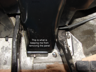

In order to get to the Courtesy Light Relay you have to remove the carpeted panel on the drivers side.
In order to remove it you will have to remove the fastener shown in the picture. Next you will have a metal panel with two bolts on the left side and two on the right side. It is possible to remove the bolts on the right side without having to remove the center console. When you have this metal panel off the Courtesy Light Relay will be on the right side of the I/P.
In order to get under the dash it is helpful to remove the drivers seat so you can lay down with you feet in the trunk. In removing the seat it helps to remove the top this also gives you more room to move in. Keep us posted.

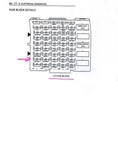

You do not say why you are trying to get to the Courtesy Lights relay so I am thinking you do not have them. Have you tried the fuses?
Perhaps this will help you diagnose what your problem is.
