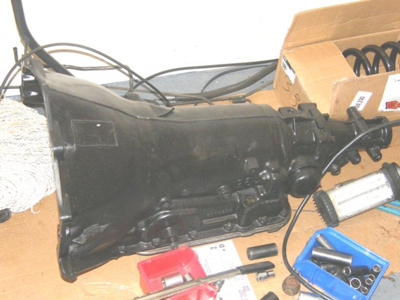

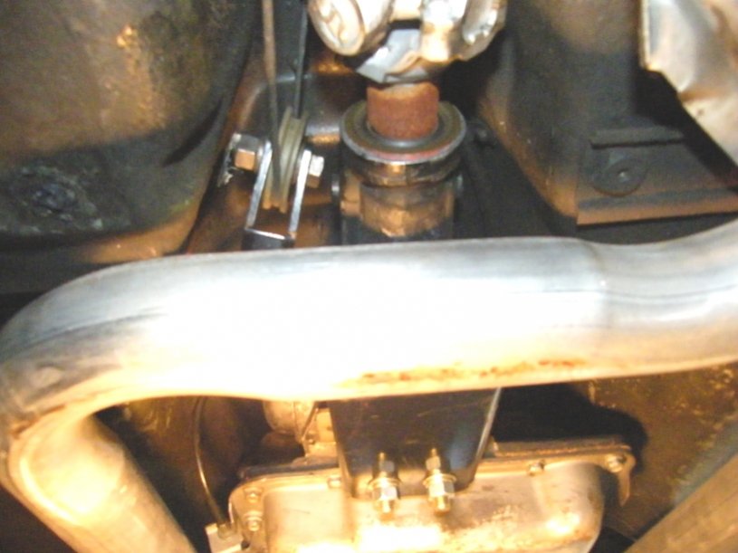

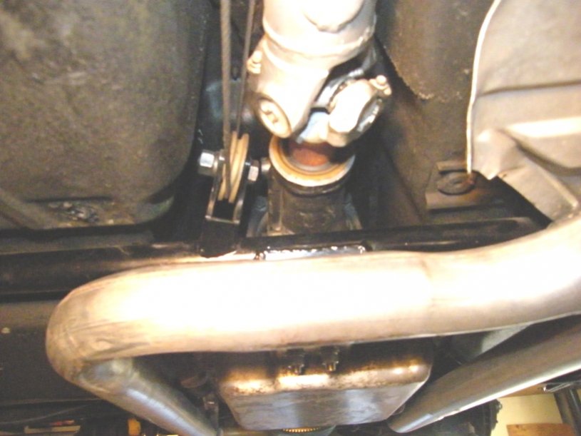

DSCF1871.jpg,Tail_Housings.jpgThere are three different tail sections. I bought a custon built 90 GMC truck 700R4. They installed a Corvette servo pump, shift kit and a 13 vane updated pump. This transmission was half the price of a Bowtie transmission. The only thing I had to do was cut the lower two bracket holders. Luckily I had a porta-band saw and die grinder. They are not needed on a Corvette and were in the way on install. It's the tail section in the middle and you can see it on my transmission before install. The tail section on the right is the correct one. I measured the overall length of my th350 vs. the rebuilt 700R4 and came up with the 3" measurement. You'll have a little play in the yoke so 1/2 inch shorter probably wouldn't matter.

All 2 wheel drive 700R4's measure 30-3/4" in total length.
