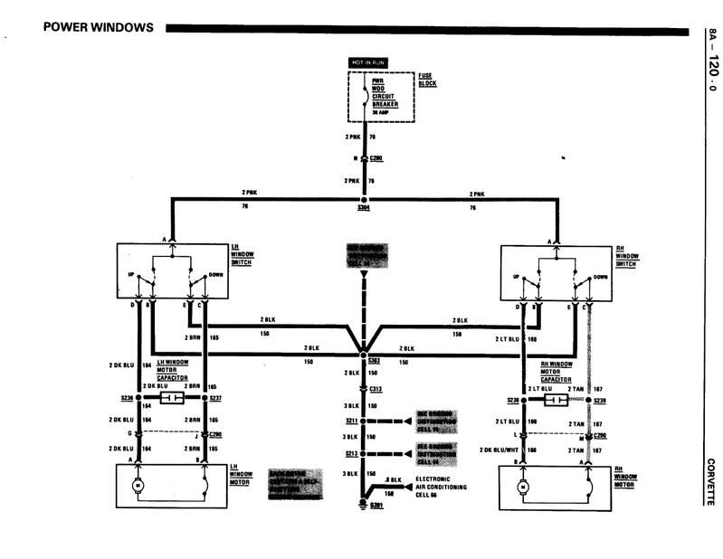

the drivers window is not going back up, then my husband connected some wires back that weren't somehow after several hours later, after he did that he tried the window again and it went back up.
If the window motor always works going down but sometimes not going up, most likely one of window switches is bad, has a loose connection or dirty contacts. The motors work on 12 volts DC. The direction the motor turns to either raise or lower the window is dependent on the DC voltage polarity that is applied to the motor.
Here's the schematic of the window motor circuit.

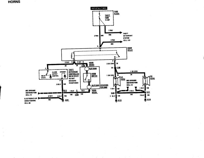

since we picked it up there is this constant clicking like the sound the blinker makes but its by the radio area. He had connected the horn back up one of the wires disconnected then when I opened the car the alarm went off, starting the car didn't stop it he had to disconnect the horn wire he had previously connected.
The clicking noise is probably the horn relay being controlled by the factory alarm. The horn relay is located behind the Driver Information Center above the radio.
Assuming your car doesn't have an aftermarket alarm installed, here's how the factory alarm works.
First roll down one of the windows.
With one of the doors open, if you look at the Driver Information Center (DIC) which is above the radio area, you should see the Security Light blinking.
With one of the doors open, when you use either of the power door lock buttons and lock the doors, the Security Light should go solid (Not blink).
Get out of the car. When you close the door the alarm will now be armed.
To test the alarm, reach in and open the door either by using the power door lock button or manually by using the slide button.
Open the door and the horn should pulse on and off. To shut off the alarm, use the door key in either door and rotate it left and right then back to center position. The alarm should disarm and the horn should shut off.
Here's the schematic of the Horn. The horn can be manually operated by pressing the horn button on the steering wheel or by the alarm.
