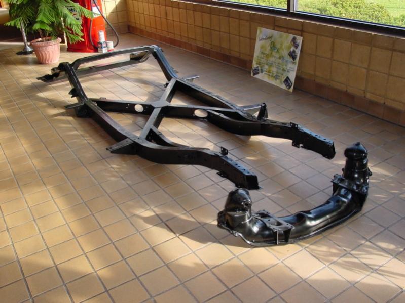

Here's a photo of a C1 frame that shows the two missing longitudinal support rails; each one also has a body mount bolt hole for the front of the floor pan. Paragon has them for $130.00 each, called "Frame Support Rail".
:beer
:beer
Well I'll be darned!!! I never would have thought they made these as reproduction parts! Amazing! That's sure the simple answer. Just order them and install them. Thanks, John. That really helps!
