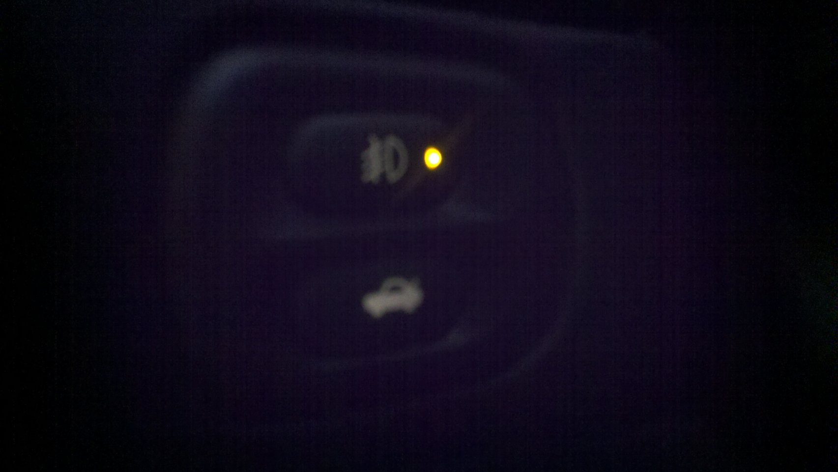

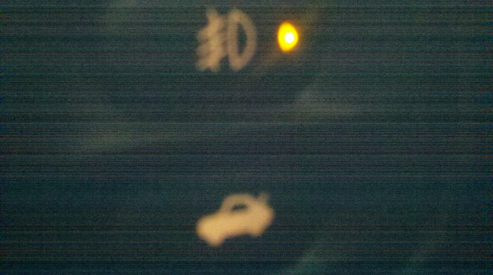

I couldn't tell ya about the bulb thing. Both light up on my '04 vert. Here's a couple really bad pic's I just took for you to enjoy.
