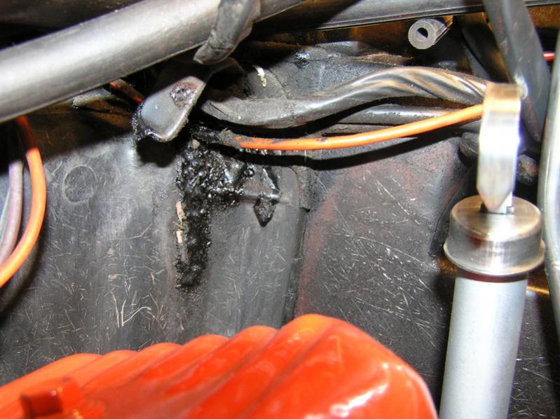

IMG_4510.jpgAll my other ductwork is off along with all other nuts/bolts. This is on the top left and it is holding the heater box on. I tried prying what appears to be a clip (on what appears to be a flat head rivet") off but it didn't budge. It is whats holding the box on. How does it come off - there is nothing on the opposite firewall side either:ugh.Heater box.jpgHow does this come off.JPG
Any help will be much apprecitated, Thanks, Fred
Look under the hood at that locatioin. AC boxes have a couple of studs; the nuts have to be accessed from the engine side.

It's off. The "mystery" nut was holding a clamp which was holding 3 wires.
I poked a wire thru the bottom nut location and measured (from inside) the distance upward - found the wire coming thru the firewall and measured the distance upward - and still couldn't believe it when I pryed the clip apart and moved the 3 wires. The hidden bolt location.jpg
