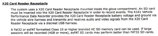

I was using a SanDisk Ultra 256GB XC 10 SD Card on the First 4 C8 Drives with no Problem. Then the PDR
Auto Record failed to Record Drives, so I turned Auto Record OFF and tried to Manually Record PDR.
The PDR Record Button is Grayed Out (Not Allowing Manual Recording) either.
Went to Dealer and after they looked at my SD Card, printed out the Attached Service Memo which states a HC type SD Card must be used.
OUESTION-
1- Has anyone had success in using a XC type SD Card???
2- What SIZE & TYPE SD Card are you using with success??
