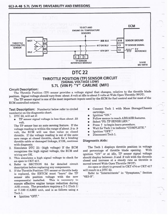

This is for information purpose's only since it is from 93 manual. Take particular note to the second sentence. If you are getting fuel in the oil there is the possibility that the ecm is being told by the tps that it is in wot. If that is the case then the ecm is going to have the injectors pushing full fuel loads at the engine. If that is what is happening it seems to me that it is possible for you to get unburnt fuel passed the rings and into the oil. What this compares to is on the old carburetor engines if the float did not shut off properly the fuel would be pulled past the needle valve and the engine would be running rich.
It was running very rich, but check out my latest post. Thanks John.
