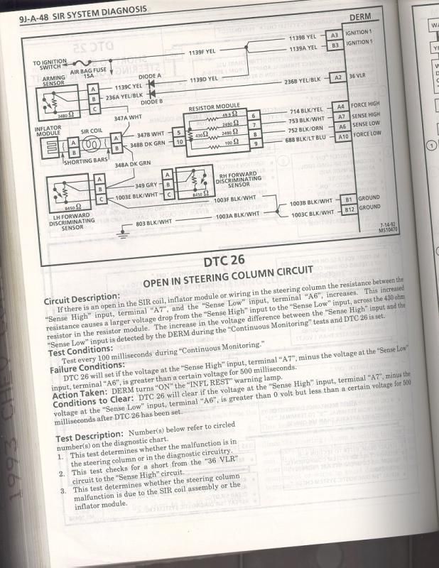

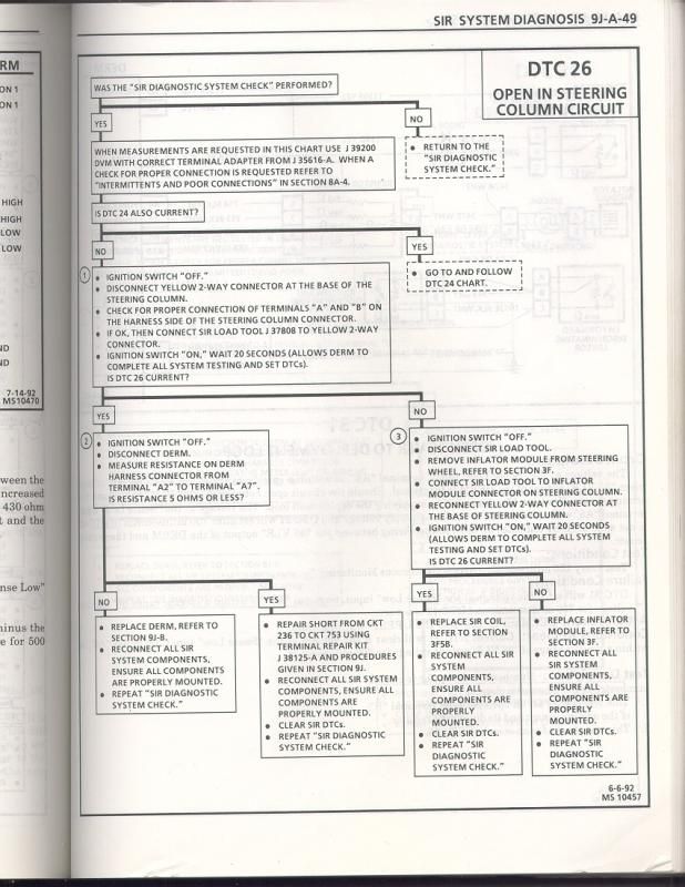

I did that and it shows a code 26
26 is an open circuit in the steering column for the air bag circuit.
At the base of the steering column you will see a two pin wiring harness with a yellow
wiring jacket around the wires. That is the air bag wiring circuit that goes up the steering column
to the air bag.
Disconnect the negative battery terminal for 10 minutes before working
on the air bag circuit.
Make sure that connector at the base of the steering column is plugged in.
On the back of the steering wheel are two allen bolts (could be torx). Remove them
and the air bag pulls straight off. Disconnect the electrical connector from the air bag.
Remove the steering wheel.
This will expose the clock spring.
The purpose of the clock spring is to allow the air bag circuit to remain in contact with the
air bag contacts when the steering wheel is rotated.
When you remove the c clip that holds the clock spring on and lift it up, on the back side
of the clock spring a spring loaded pin pops out. This locks the spring in place and keeps
it from unwinding. Many people press on that pin and the spring unwinds and breaks.
When you install a clock spring with the steering wheel straight ahead you manually wind
up the clock spring half way and place it in position.
You need to remove the air bag and as shown in this video check the resistance of the wiring and
clock spring for continuity.
