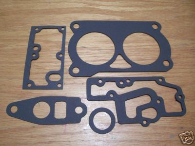

Now, regarding the FIRST technologies intake, it does not look as if the hard parts as Aurora put it, will bolt up. Look at the bolt pattern on the inlet of the throttle body - how close does it match the rams-horn that must be attached?
IIRC, the FIRST Tech design could have its throttle body mounted on the side or the front, making it a fine choice for street rods with clearance issues for inlets.
Here are the gaslets of each to compare:
FIRST:
STOCK TPI:
