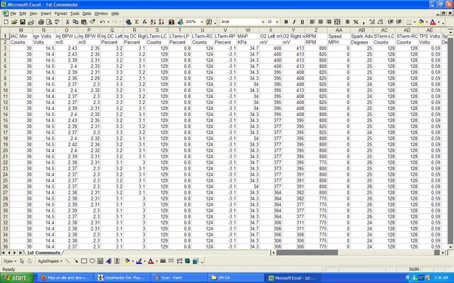

Can you post up your scan results...
Does the readout give voltage equivalents? Or absolute values? Like below: (never mind my scribbling notes)

For those that may not know Datamaster software lets you record a session and be able to play it back. I can send the UNI file to anyone that would like to take a peek at it or I exported it into a CSV file but it has 2300 data points so posting it here probably won't work. But I'd love to have someone look at it that can say " see at Data point xxxx the car is doing this and it should be doing that because this BLM is leaned out due to ,,,
