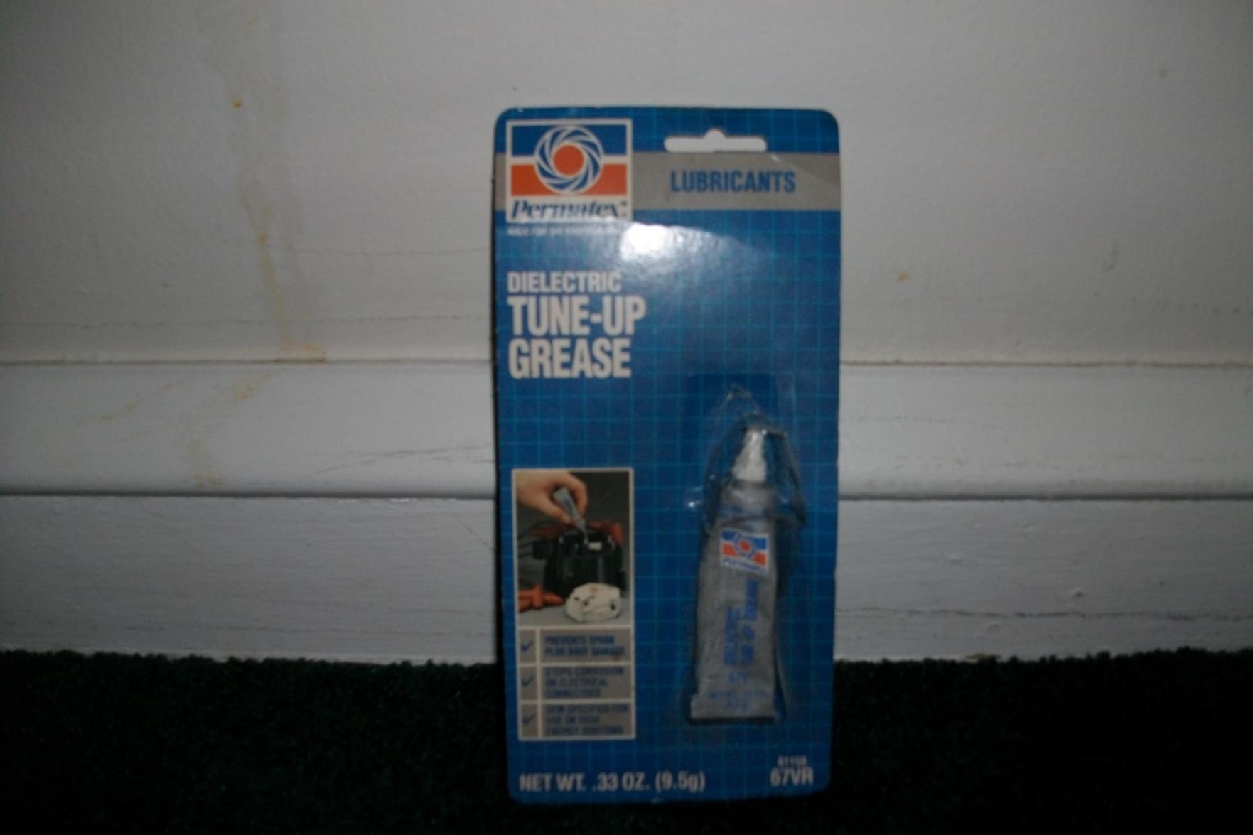

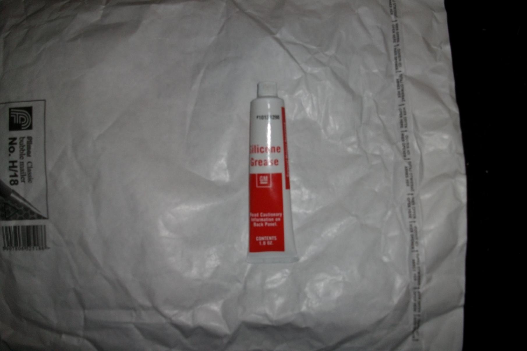

I have used both of these with great success and if you need a larger dose I go with the 3 tube of silicon tubes of silicon sealer or lube from Mid-America it's GM part #10131290 and or the smaller version of the same thing, (But it is almost a universal part in stock anywhere on the plant, "Permatex Dielectric Tune-up grease #81150 or #67VR, either way you have the same stuff in both items. I used the GM silicon ion all of the seals on my two vehicles and if you buy the 3 tube item from Mid-America you'll have enough of it to last you for the next five years. . . If we make it that far. Good Luck !
