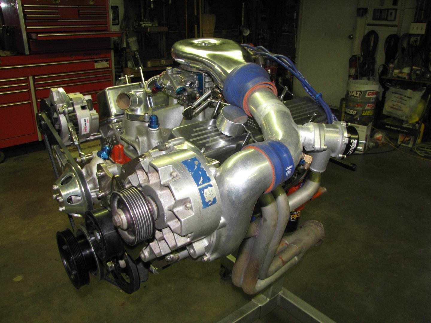

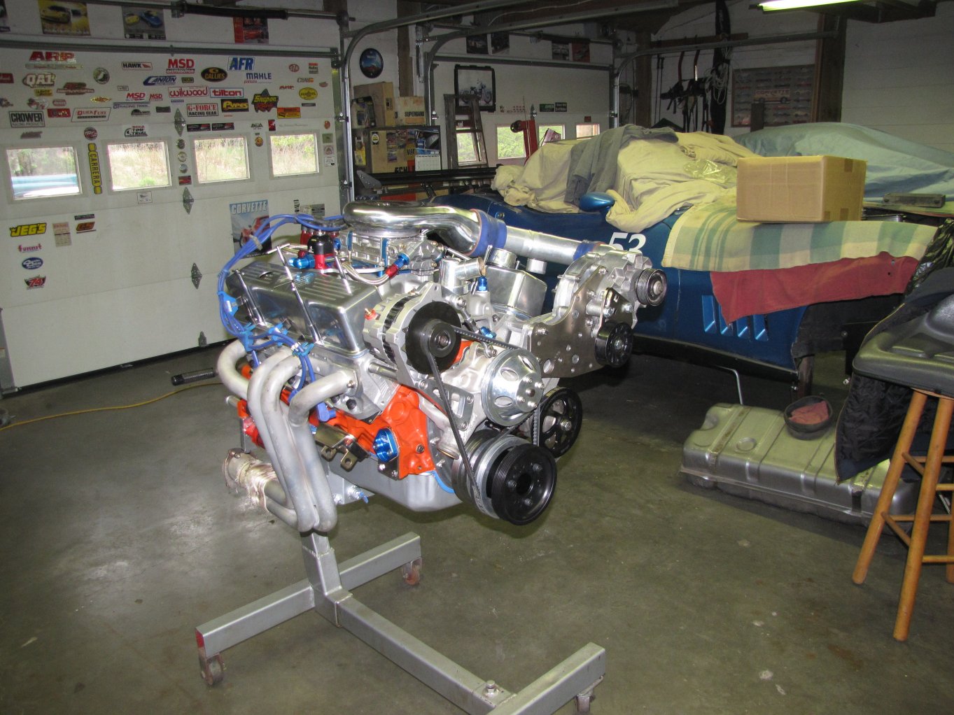

Finished up the main engine assembly Sunday. Now to finish up the engine compartment so the engine can go in. TIMG_1589.jpgIMG_1583.jpg

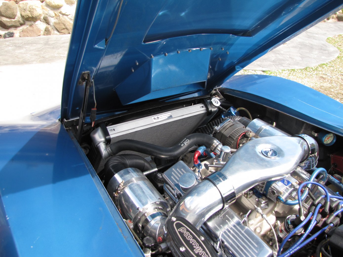

Been out of it for awile, some medical issues. This is the hood we made [lotsa help from friends] Took 18 months from start to finish. It's shown in top pict so I've been running it awile [kinda proud of it]. When it was first installed there was also a schroud on back of radiator and it conducted all of the rad hot air out through the hood. Fan is mounted on front of radiator.blue car 002.jpgblue car 070.jpg I took that schroud out in lue of installing a cold air intake system, that is also sitting on the shelf. This is the engine that came out, 411 RWHP, what a hoot to drive. So back to the tank story: got the new engine in [ sorry CAC wont allow any more picts] and every time it's started up if squirting fuel out the carb vents. So after a bunch of calls to the carb guy [You know that blow through carbs cost almost 1k] and lots of fuel all over the floor [and I mean a lot] I find out I need a bigger return line to tank. A number 10. OMG where is that going to go. So it's ordering time from Summit and another buchfifty, ouch this conversion is getting expensive. Remove the #6 line and install the #10. Turned out looking good. Did I mention that that 6AL-2 system needs the timing programed with a laptop [like I know how to do that]. SO I get help from Tim, and we fire it up again, running pretty good. Almost out of fuel time for test drive, on way back from fuelstore, went to use some of that fuel, I guess to much cause it went bang then knock knock knock, blew a half shaft u-joint. Only 1/2 mi from home, so just limped . More to come. T

That hood come out great. Sounds like the engine did too. I had a similar thing happen once with a '65. I was also fortunate to be close to the house and the posi drove the left side to get me the one block home.
Tom
terrys6t8roadst: It looks great and thanks for sharing pictures..
The hood is a beauty!
That's a mighty small pulley.. Evil grin....

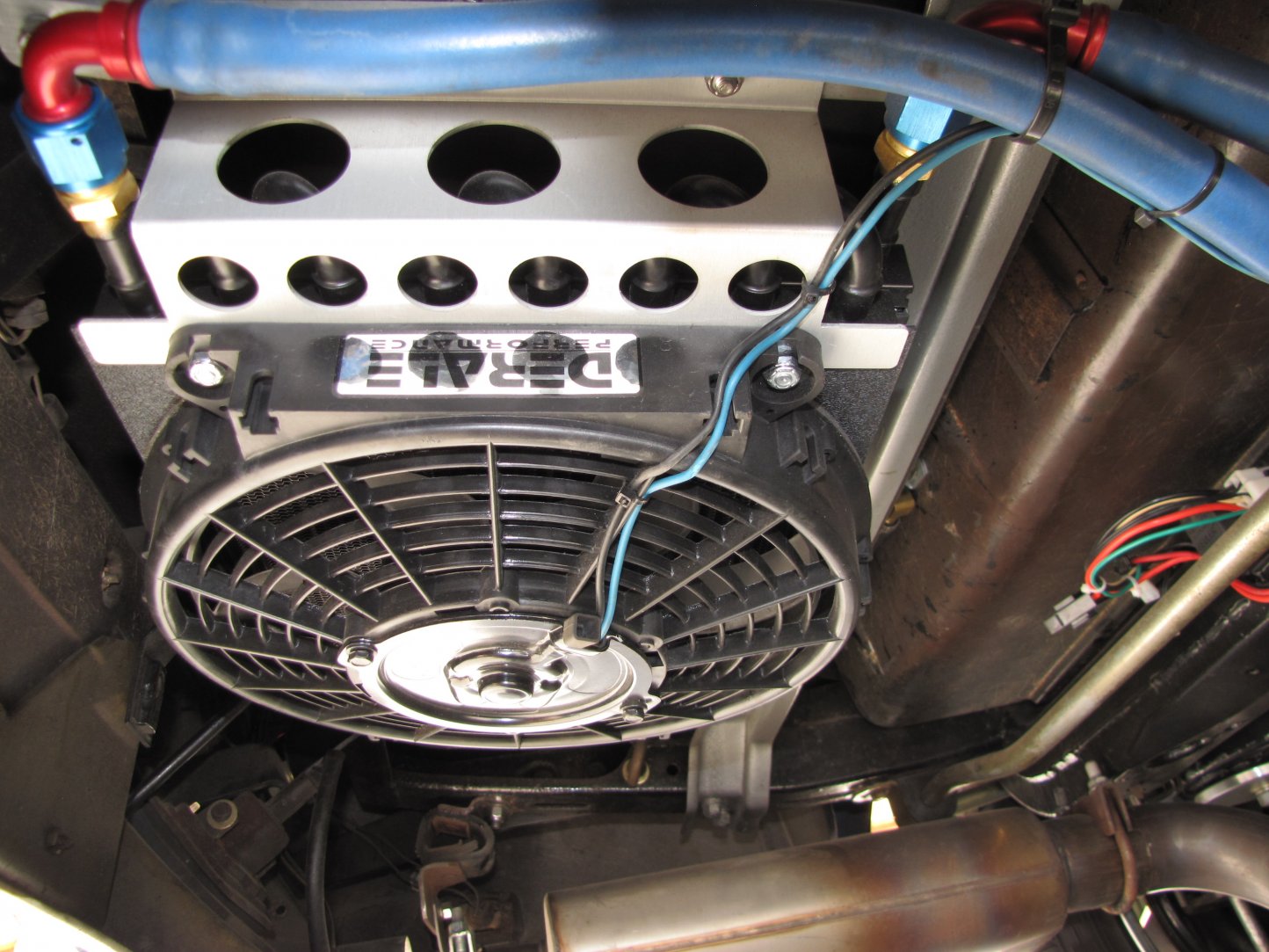

blue car 039.jpgblue car 043.jpg I suspect that you all guessed that I like to take this car to the track. Living about 45 minutes from Road America seem like a good choice. What a beautiful track. 4.1 mi. and 14 corners. Corner 5 is my favorite, while going through the carasoel into the kink is probably the scariest. When I first started the car still had the 3.36 gears and the original 327 4/speed with Michilen P/S tires. Still had the OEM chairs and they gave some crap at tech in because the shoulder restraints did not go through the seat. Next winter it got some Corbau A.4 chairs [nice upgrade, kept my but in place]. So my buddy Dale [who just loves spending my money found this Auburn 3.73 gear set with new brgs, seals and Auburn posi unit, all brand new for 650$. So now everything is in place for me to go fast right ? Over the course of two days at the track you get 10- 25 minute sessions. For me approximately 7 laps and every time after the session the rear end is banging, hopping every time I turn. Then there is gear oil all over the back end. We put at temp guage on diff [infared] it reads 325F. What can I do but keep it full and go for it. The next week I sent the diff back to Auburn, they tell me 650$ to fix a brand unit, I tell them to keep it. Get a new Eaton and put that in and also the cooler system that I pictured.
