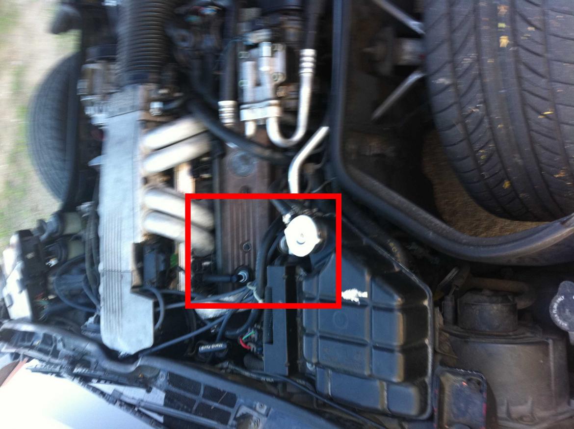

#3 i have no idea what this is and i am just wondering what in the world it is. it isn't protected or anything. here are pictures to help you answer my question
Passenger side, around the same place where spark plugs are (cant remember what its called, the short block?). beneath the vavle covers, same distance from the ground as spark plugs.
it isn't well protected. so.. *shrugs shoulders*

The other part, while it's a little difficult to tell because I don't have access to my early-90s service manuals right now, but my guess is that's either the ETC temperature sensor or it's the temperature switch which turns on the aux. cooling fan.

The switch is always driver side between #1 & #3 cyl and the opposite side of the block (catty cornered) is the sensor for the dash display that CAN render a different reading than what the ECM is getting from its very own sensor in the front of the intake. Thats the really great thing about Corvettes.....everybody gets their own temp sensor.....:chuckle
Why settle for 1 or 2 when you can have 4, 5 or even 6? :L
