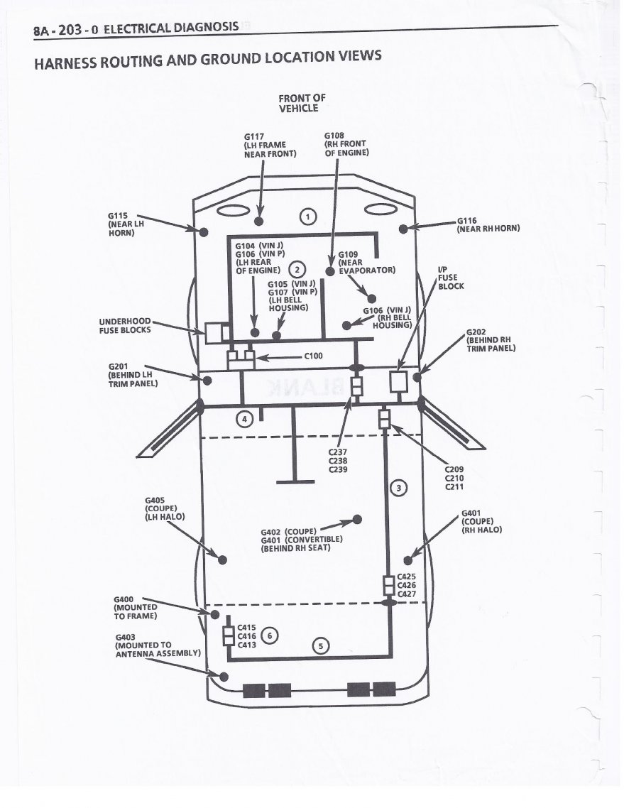

Recheck the battery connections for good contact. I have had bad battery terminal connections that give just enough power to light up the dash but not turn the car over. If it still does not start clean all the ground wire connections.
Thank you John...that's a lot of grounds :)

Locate and clean the G104-5 ground collection on or near the oil filter. Thats the most important of them all. Look for approx 5 wires on a single bolt.
