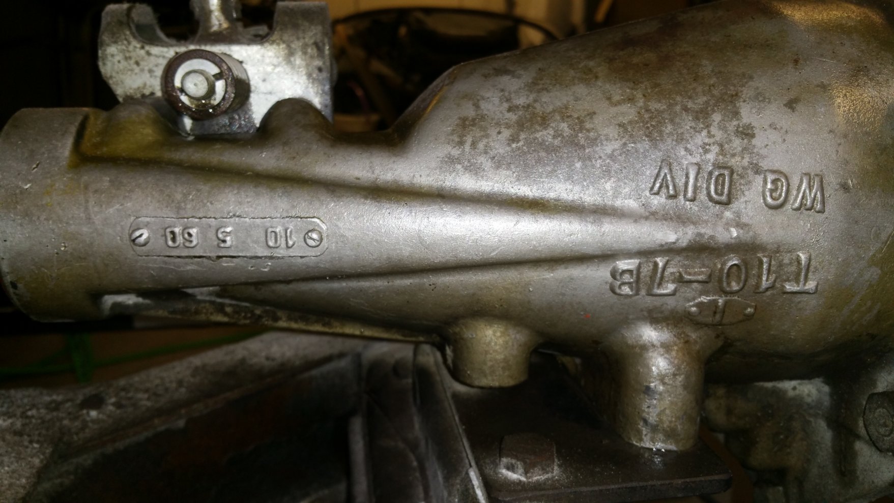

Is it possible to get an original or a new which is produced to look original? Here is the trans also.20151228_163048.jpg
Is it possible to get an original or a new which is produced to look original? Here is the trans also.View attachment 22513
It looks like your transmission is too new for the car also. Check in the NCRS Driveline, either the print version or the online version and you will find vendors that deal in these items. They gather differentials and transmissions and recondition them, and may have a correct date for your car in stock. It really depends on how picky you are about having everything correct. NCRS doesn't raise a car in the air or crawl under one to judge these items so you don't need to worry about them that much. I also noticed a few wrong year parts in the photo of the engine before body lift. What are the stamped numbers at the front of the passenger side cylinder head on the block deck?
