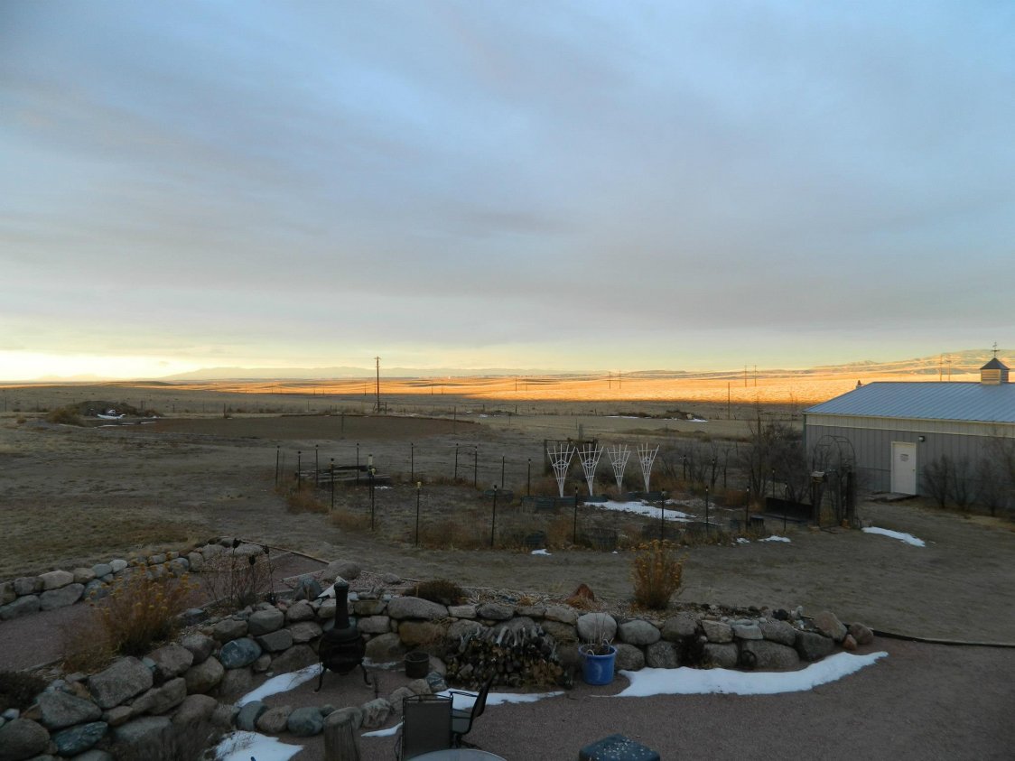

My pole barn was built by a company called Morton. They have a rather unique way of hanging their sliding doors so there is never a problem with rocks/stones as the door has no real bottom track. As to the drains, Colorado wasn't real fussy back when it was built and seeing as how it was originally built as a horse barn, it was considered an agricultural building so we didn't have to pull a permit. After we got out of the "horse business" we turned it in to a play toy storage building. By the time we got the Jag, Triumph and the Vette in to it along with the tractor, kayaks and bikes, it was pretty crowded (we never took the three 12 X 12 stalls out after the horses) so go BIG! The fiber stranded concrete was pretty common in horse barns as you don't want any kind of metal reinforcement ever coming out or through the floor. I think it was actually cheaper than a mesh reinforced floor. Now that we're in Michigan on a small lot, I sure miss the barn. I don't have a real good photo of it but you can see the side panels up on the roof line. And while I'm thinking of it, we went with the commercial 5 inch gutters too. That expanse of roof has a lot of run off.
