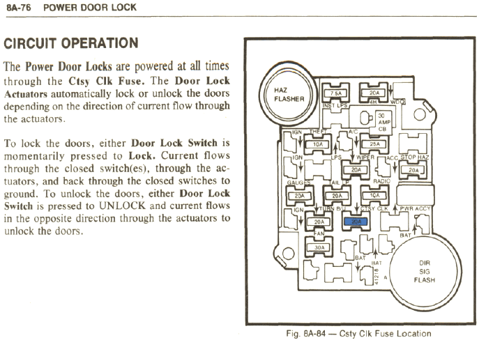

Anyone know which fuse is for the power door locks on a 1981 corvette? cant find it in owners manual or on the fuse panel

Here's from the manual for the 1980. I'm guessing it should be similar for the '81. But maybe not since they introduced other computer dodads that year. Click on or hover over the pic for full size.

The door locks are a relatively complex system that uses BOTH switches to make it work. If it is only working in one way, it is a 99% chance that one of the switches (or wiring to the switches ) is bad. Because of the complexity of the circuit, you cannot tell which switch (you may be able to, but the circuit is a real brainteaser). I would change them both, You can buy two switches without the word "lock" on it for about $20, you can then make a decision if the word "lock" on the switches is worth $70.
