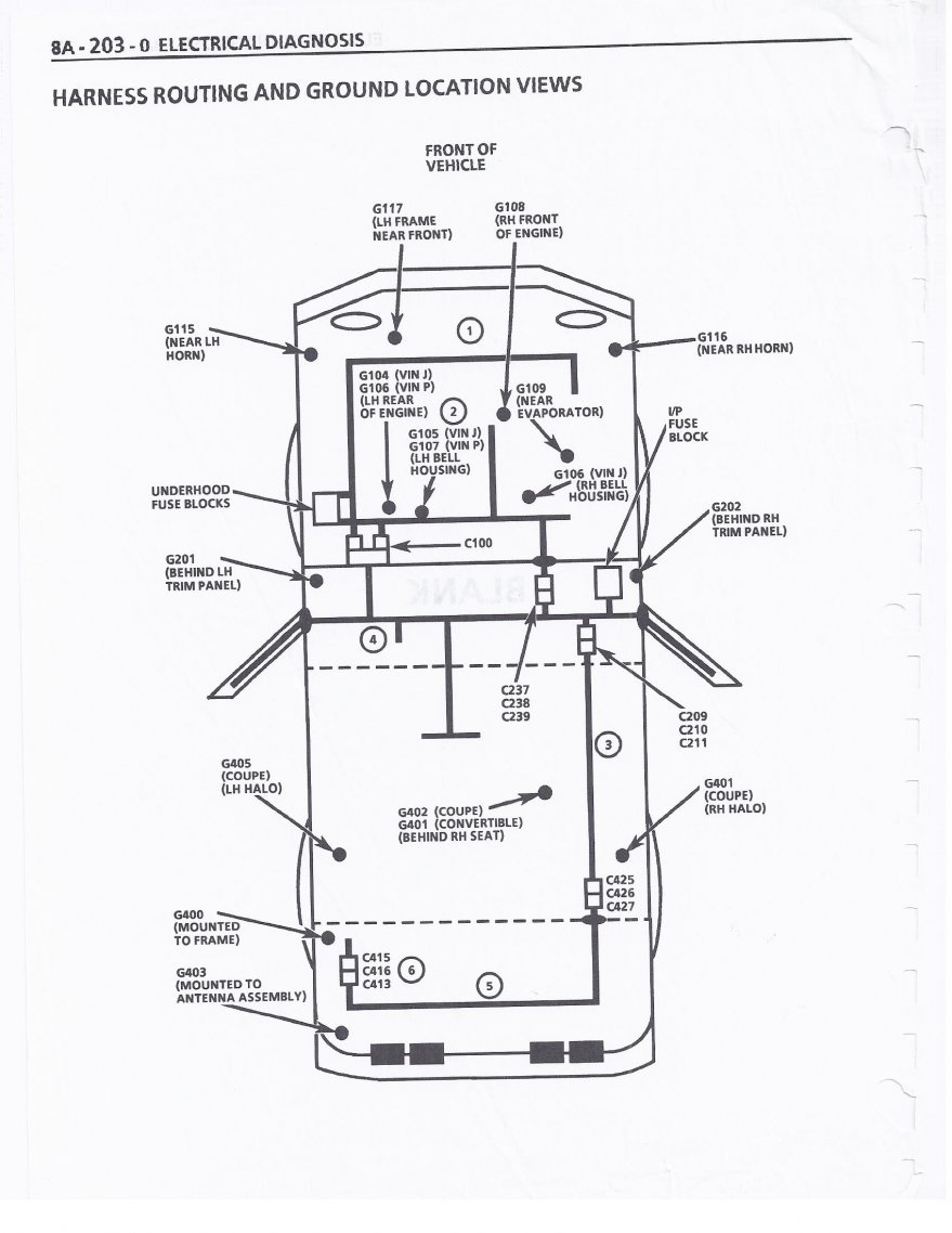

The grounds are the lifeblood of the whole car. Unlike in the past were you would check the value of the power going to a sensor or switch the ECM checks the power going to ground. Bad ground no signal to ECM it gets confused. With that in mind if the sensor that it uses to determine the coolant temp. does not have a good ground the ECM says no signal still not hot enough to turn on the fan. So as Junk said you need to clean all the grounds to be sure they are sending signal to the ECM
Corvette ground locations.jpgHere is were most of the grounds are located on the car. You might as well clean all the grounds from the windsheld forward. Be sure to get the one on the bell housing.
