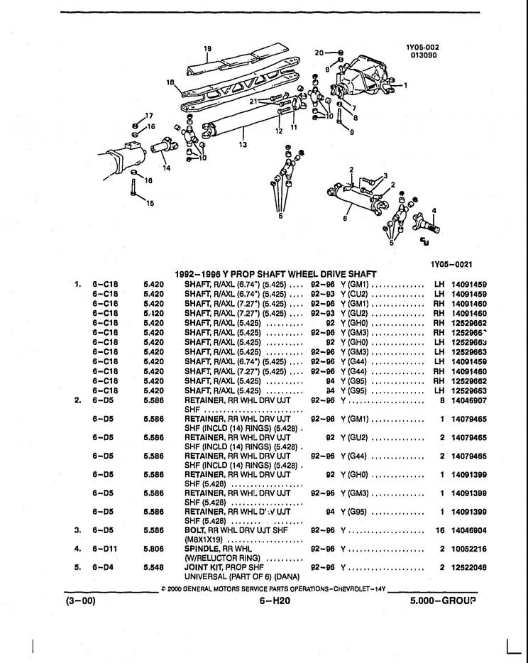

Anything here?

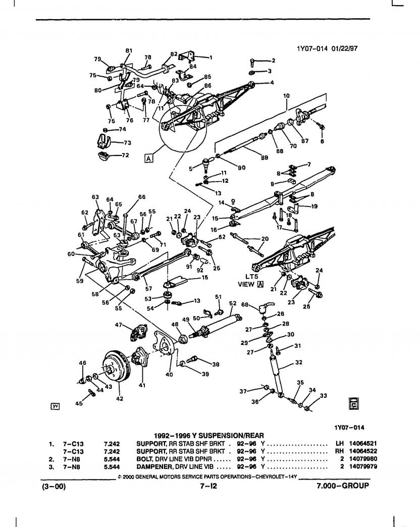

The teflon washer is hard to understand how it goes in based on FSM pics etc. It has a lip, and would make sense it rides up against the spindle. But the way the FSM speaks isnt easy to understand.

Neither mY FSM nor the Corvette parts-book diagram/list I have doesn't even show the washer. I think you'll see that (if that's the washer I am thinking of) that the lip goes into the seal and the axle abuts the smooth side.
