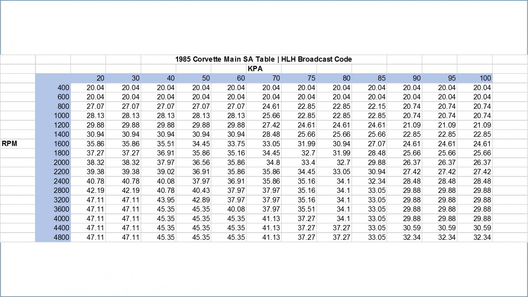

1982, 1984, and 1985 Vettes use the same heads. Spark tables are largely determined by the heads.
That's important to know because it seems the '82 and '85 Vettes did not have their BIN (calibration settings) for the spark tables saved or available.
1985 Corvette head castings numbers are 462624. Same as the 82's and 84's...
So, if you need a spark table for your 82 or 84... you can use the 85's.
Attached is an image of the spark table for the 1985 Corvette, broadcast code HLH.This is a good start if you are looking for a spark table for your iron headed crossfire.
