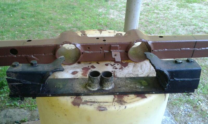

this is an awfully old thread, but I thought I might revive it w pics of my current project of repairing and replacing the transmission crossmember in my 63.
this is what some previous owner did to get a T400 to mount up to my 63. what a hack job!
I just cut this section out w a sawzall (yes its a hot rod not a show car folks) and am gonna section in a replacement.

I recently got an old crossmember and am gonna make it removable, and fit a muncie to it correctly.

welded a channel to center piece.

gonna drill bolt holes to mount it to existing crossmember pieces that are welded to the frame.

lines up well! just need to drill some bolt holes now.

Nice work, looks like you could cut out most of the center section of the cross member and then modify it with some welded on channel iron to bolt back in place. I installed a Tremec with the engine still in the '66 but it was a pain....
You got the trans out with the crossmember still in? Wow, that must have been quite a task!
My removable section is all bolted up and installed, certainly not ncrs, but very functional for a driver.
