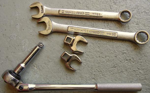

Here are the tools used (16/18mm open end wrench and crow's feet):

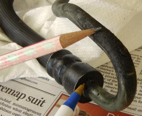

Here is the old hose (pen points to where it was leaking, pencil points to the years of residue):
