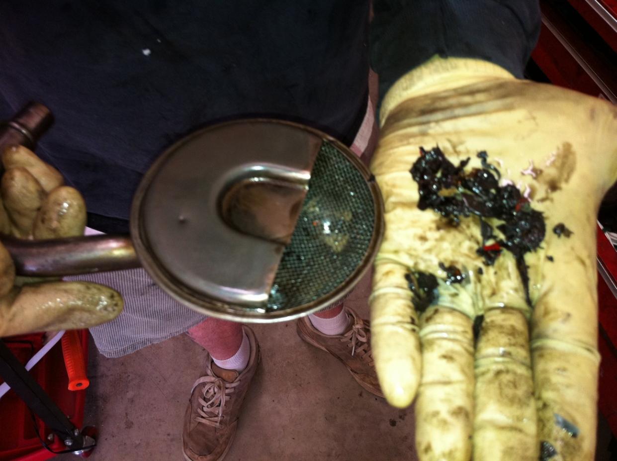

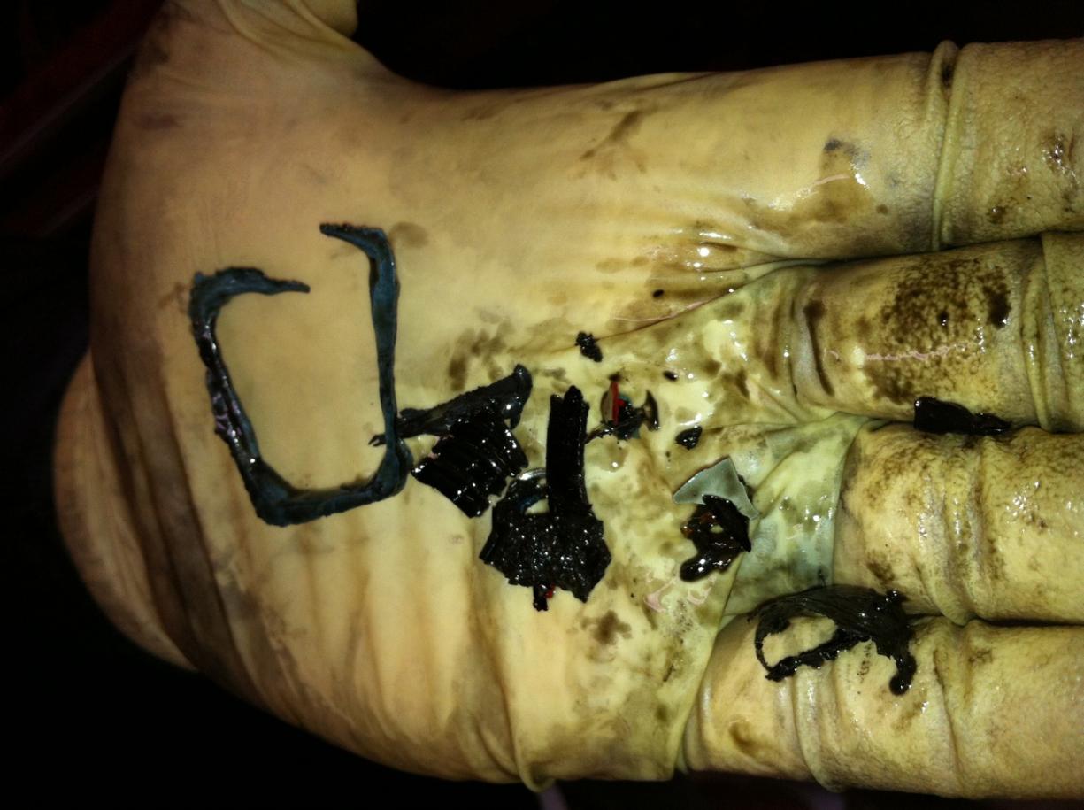

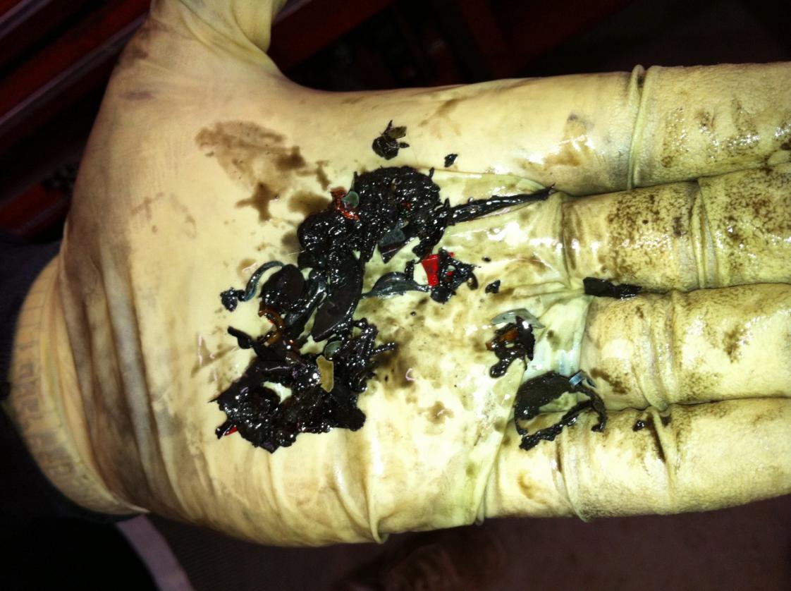

As far as the engine rebuild goes, it's in litigation now...got a high profile lawyer on the case now. My son and I dropped the pan, pulled a HANDFUL of RTV from the pickup tube and screen, installed as new oil pump, ran an engine flush with a new filter and refilled it with a second filter....she's got 30lbs@1500RPM and 10lbs at idle. I figured it was good enough to drive while I'm waiting on the outcome and the best thing is...I still don't hear a knock (fingers crossed) :D

Thats fair for 40 wt....I have to believe that 5-30 would not do well at idle. With 10 lbs @ idle with 40wt I'd say the main beaings were well worn. The clogged oil pump pick-up screen could have caused oil starvation that led to the bearings grinding themselves to pieces.
It sounds to me like the RTV was the culprit, not necessarily the grinding pad, although that did'nt help. The collection of trash that went into the pan is what caused the damage.
I wonder how many other vehicles that wanna be mechanic destroyed during his time at that shop and if anyone else had come forward? That would be interesting...if there was a history at that shop or with that incredibly stupid mechanic.
I pulled out a compete square of RTV in the shape of an intake port...sigh...got more pics and I'll post them soon.
The analysis of the oil came back and saw no trace of abrasive material in the sample, so I agree with your assessment of it boomdriver; a case of oil starvation.

Here's what we pulled out of the screen and pickup tube....
Looks like yankee tap water - Chunky - Style.
I don't think I'd buy new parts to go in such a motor - I'd have to iPhone the shop hack that worked on it, send pics, and tell him to send a check.
Either that, or I take the lid off a can...
I'm amazed (and so is everyone else for that matter) that I've kept my cool about it...but I have to remember that I didn't deal with the shop, my son did and the car was a gift.
If I were to get into it with them at this juncture, it would be a waste of talk time ;)
