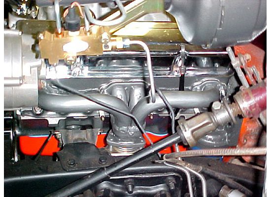

You could buy a pair of original Corvette ones then you would be sure that the side pipes would fit. Here are my '81 manifolds on my '69 stepside after I removed the heat shields, AIR pipes and coated them wit Eastwood Stainless Exhaust Coating. '81s are 2" outlet. "82 and newer are 2.5" Got mine off Ebay for $35. and they looked like crap before I bead blasted them.
Gotta Love Eastwood! Just what I Want to Do! Looks Awesome!
You could buy a pair of original Corvette ones then you would be sure that the side pipes would fit. Here are my '81 manifolds on my '69 stepside after I removed the heat shields, AIR pipes and coated them with Eastwood Stainless Exhaust Coating. '81s are 2" outlet. "82 and newer are 2.5" Got mine off Ebay for $35. and they looked like crap before I bead blasted them.
Thanks for this info Man! That's just what I want to do! I was gonna ask or make a post if I could take the sheilds off. I'm very New/GuyWithFirstVette and Chevy Small Block. Wanted both since I was born. I used to tell my wife about it all the time. The C4 Vette is Perfect for Me, It's "Spine Friendly".

I Love Eastwood. I was just looking at their catalog yesterday. I have several of their coatings. They have every kind of specialized coatings. They have Great Kits for doing powder coating, and different types of metal coatings, air brushings.
Your manifolds look Very Nice, Beautiful, Super Job! Did you notice any sound difference after installing them? I don't think I'd remove anything, like AIR pipes or anything as I think maybe the performance of the car might be affected. The computer might get upset about it if I started cutting things off. My 31 year old Corvette, base as Base, stock as Stock, All GM parts, 119,000 miles, runs like it just left the showroom and I believe it could and wants to fly 150 MPH as claimed. Another thing, regarding it's superb handling, if a baby suddenly appeared in your lane, I believe at least a C4 Corvette is what you'd want to be driving.
