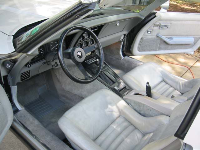

Think this is the silver grey you guys are talking about..could be oyster too...who know..the 152 color code sounds familiar though...good luck! \
Joe..

Thanks for the replies. This is what is so confusing. There seems to be a silver, as well as a smokey color (as Joe pictured), but I cannot find what actual color they are called. All I know is I ordered "smoke gray" and the box said "81 slate" on it and it looked more like Joe's interior than silver. Very confusing. I'm guessing that the aftermarket suppliers just makes one or the other, but calls them both the same things.
-Tatortot
