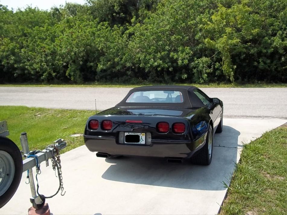

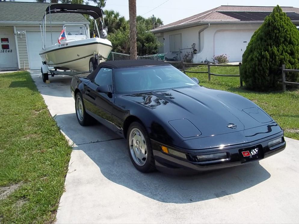

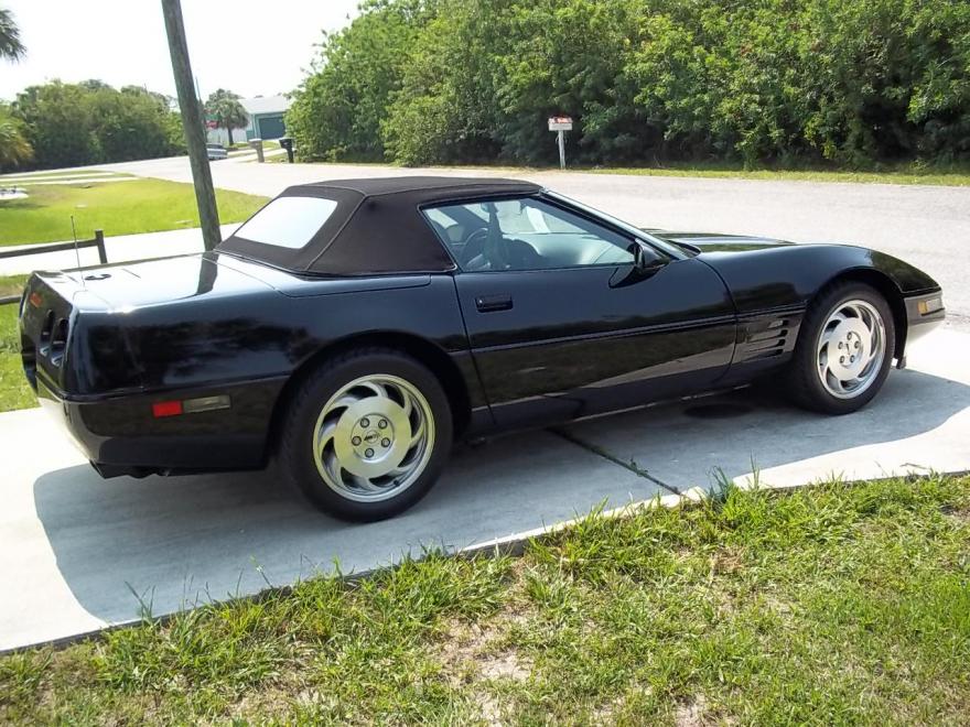

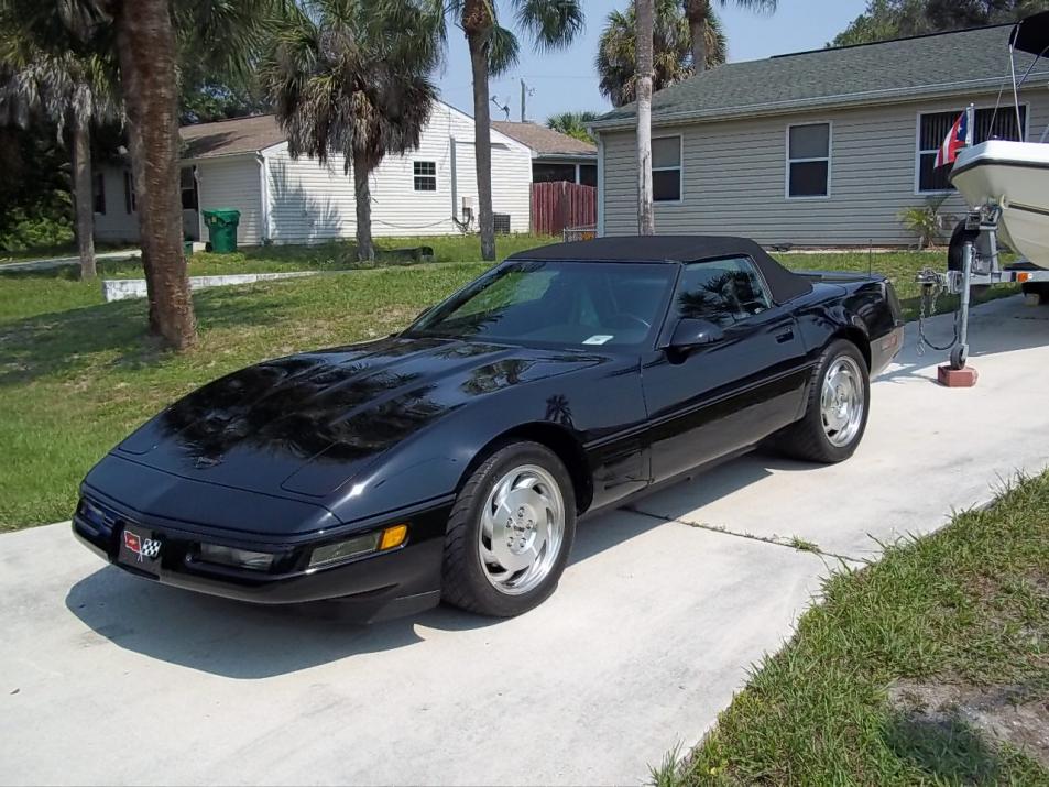

Here is the new money pit , in front of my other money pit...I sure do love vettes...:happyanim:...
.I got this car and some cash for my 09 Hemi challenger
Here is the new money pit I sure do love vettes....I got this car and some cash for my 09 Hemi challenger:happyanim:

Very nice find. I came across a 91 zo1 this morning with 23K on it. The owner has had hip and knee surgery and can no longer get in and out with out a lot of trouble. He is toying with the idea of putting it up for sale. I will keep close tabs on it just in case the money fairy comes by and dumps a load on me.;LOL
Thanks its a clean one it was well cared for....

I see your other money-pit ! I sold mine to get the 'Vette . A boat is a large hole in the water in which you throw money . A'Vette can be the same deal ,but a bit drier . I still miss me boat , tho' ! Congrats on scoring a tasty looking 'Vette .:thumb
