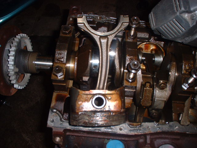

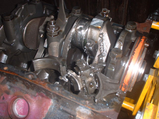

Now....hold on to your hats. I have never heard the knock that everyone says they hear. When my son dropped the pan, he pulled out a wad of RTV pieces from the pump intake tube and the screen. There was no more little metallic pieces like those found in the sample bottles.....tomorrow morning I'm going to help install a new oil pump I got and put it all back together again, drain the refilled crankcase, and put fresh oil in again if everything sounds ok.
We're following through with litigation against the repair shop in Vegas for a refund on the work that wasn't done and possibly the engine work if this doesn't turn out the way I hope....
If the pan is still down, see if you can grab the connecting rods, and move them. With the oil pick-up blocked, and a zero-pressure reading on the oil gauge, it's highly likely you need some

I'm not sure what the point of installing a new pump and reassembling the thing is...If there is metal particles in the oil, its over.
For whatever the reason,. a motor thats been run with zero oil pressure is a dead motor. The bearings are destroyed, rotating parts scored and damaged. If the pump screen was plugged up with RTV scraps, that caused oil starvation. The "grit" might just be metal that was your bearings. Without the oil analysis its impossible to say what it was, only what it is NOW.
