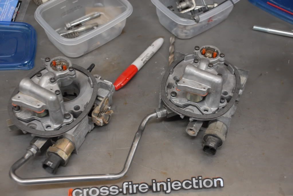

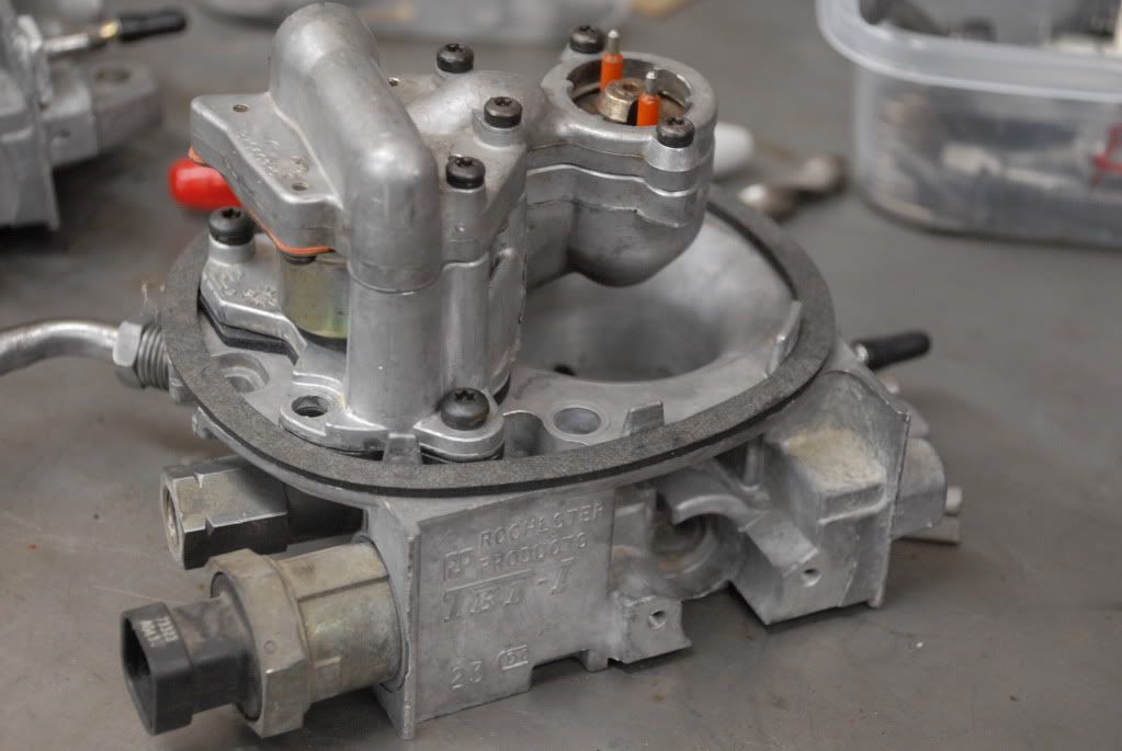

Update on my progress so far. I removed the TB's and disassembled, cleaned and replaced all of the seals, o rings and gaskets. I removed the plates and shafts. My shafts are .010 to .012 smaller than the actual bores in the throttle bodies. I ordered undersized bushings and a .373 dia reamer. My Shafts are right now at .369 -.370. That should give me the OEM clearance of .004. The factory bore was .375 and the shafts were .371. So by going undersized and reaming to the size I want I should be good to go! I also just bought another set of TB's on E bay as my back up set in case I screw up, or I will clean them up, rebuild them and re sell later. My brother in law has an 84, and we might need to do his also. Worse case is I have extra fuel injectors / linkage and IAC's still worth more than the $100 I paid for both with the linkage. Here are my TB's awaiting my bushings and tooling.....
