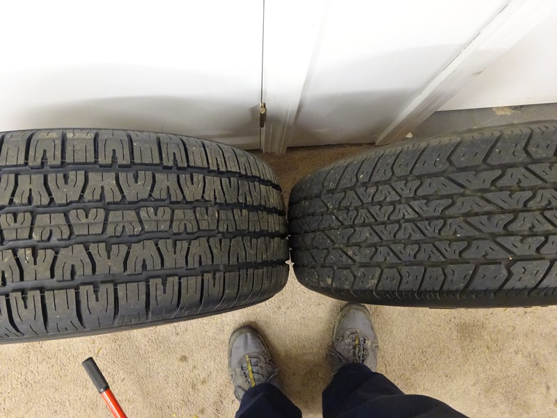

Here's a pretty good side by side comparison.
