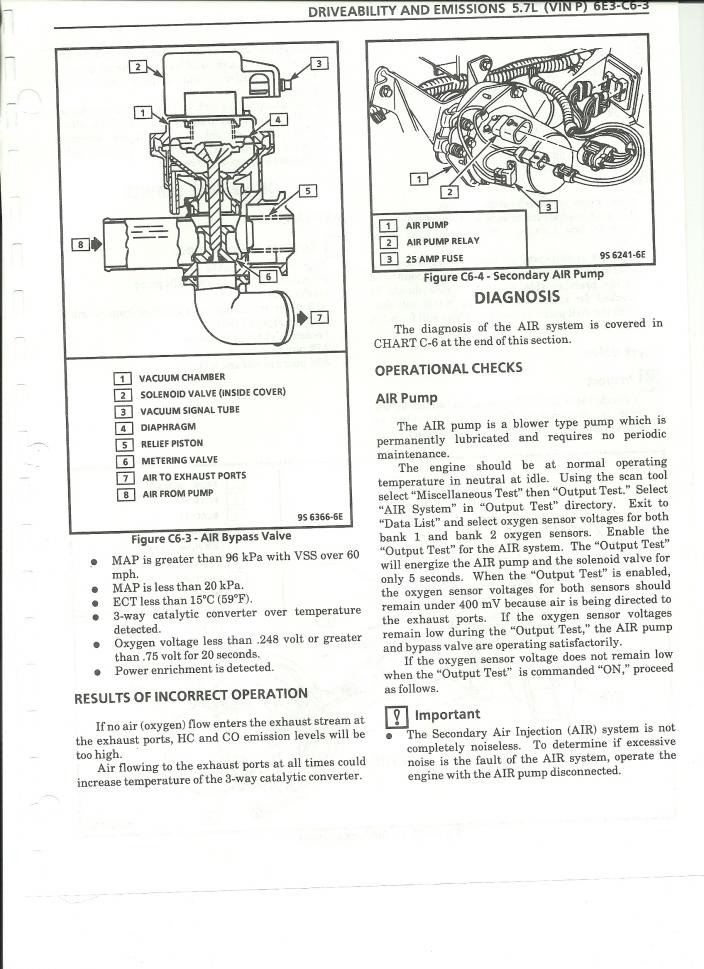

Hi.
I have somthing look like a vacuum clock located in the left front well where the headlights will be stored when not in use. This thing make a noise when the car is restarted when warm, sounds like a fan which is not having a good time. Can anyone give me any info regarding this part and what it do? It is black and made of plastic by the look of it.
Thanks.
