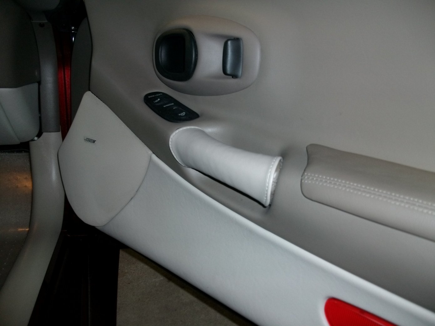

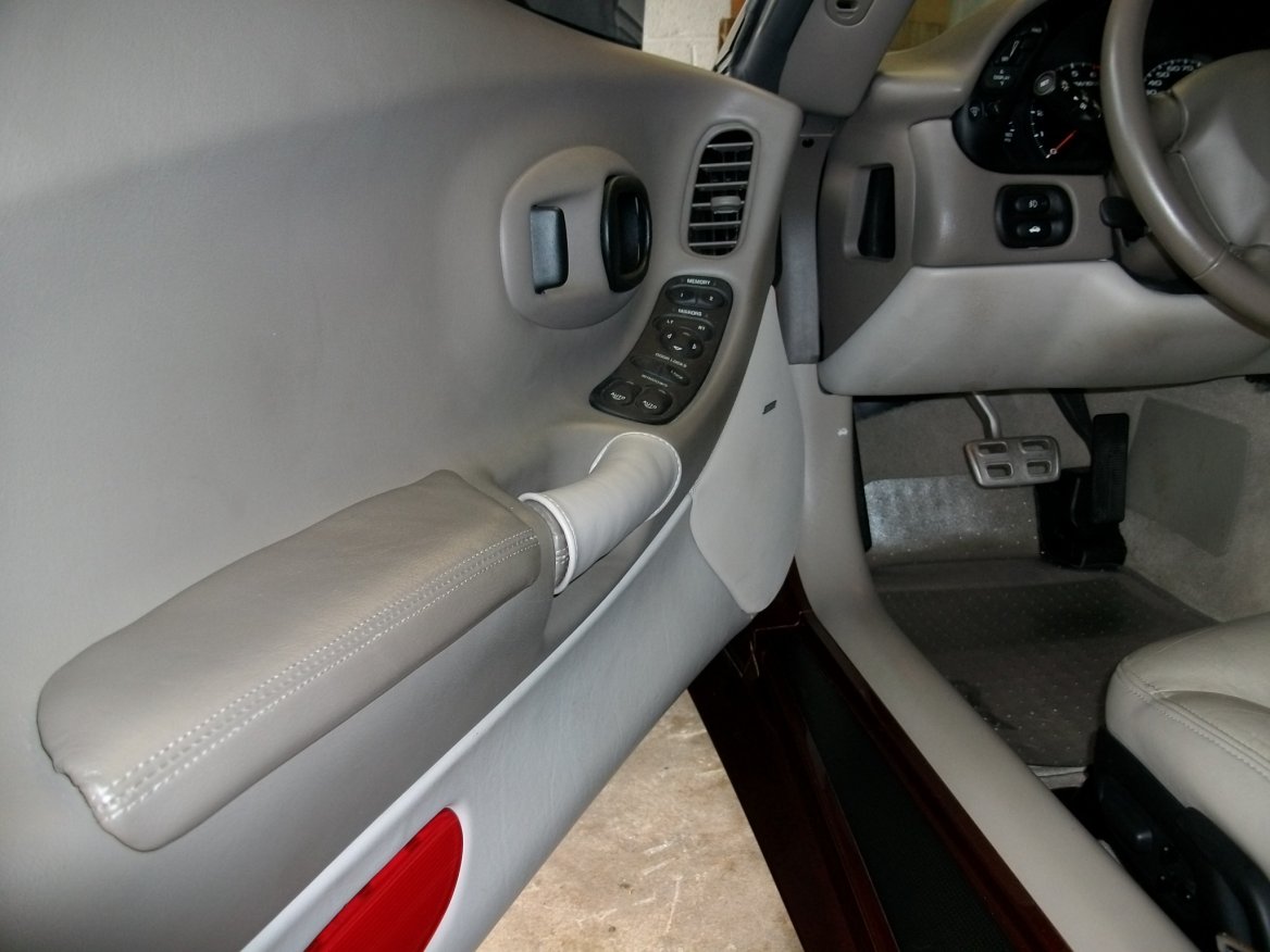

I don't think so, I have it since new and they were on it when I purchased it. They look stock same color and cut to fit the door panel. and you can see they are the same color of the door panel ? The alcohol and water well prep the door panel clean enough ? I don't want to damage the vinyl door panel ? Didn't all C5's come with armrests ? Thank you ! :w

No, definitely not. I think that only the 50th Anniversary Edition came with them. Funny, I just notice that you have a 50th. The door pulls are aftermarket though. Here's a 50th Anniversary interior.

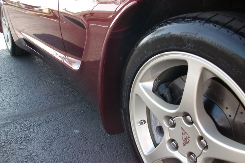

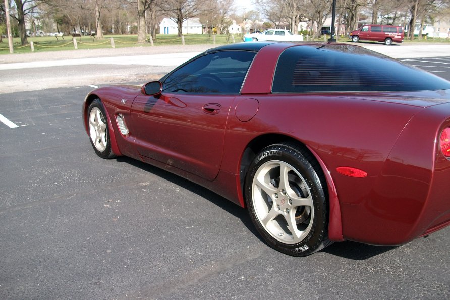

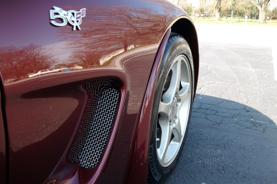

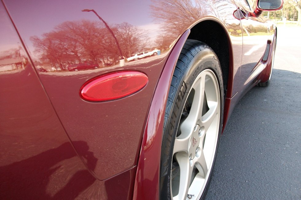

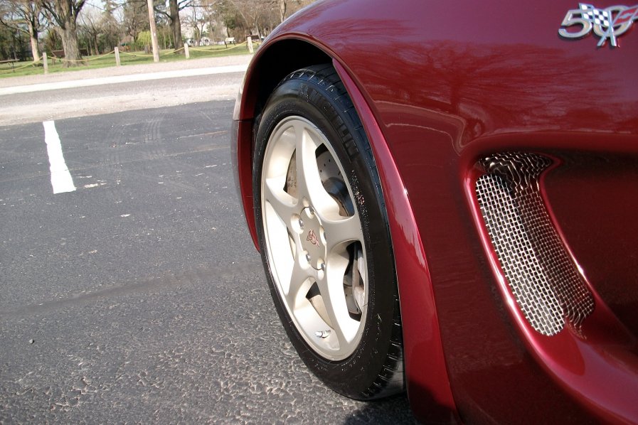

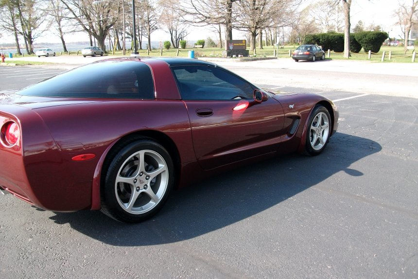

All 2003 Corvettes are considered Anniversary cars, but only the 1SC cars had the 50th. Anniversary packaged cars, special paint and different interior like special headrests and the wheel are painted in a 'Champagne' Color & a few different things. I just pulled the trigger and bought a set of Apsis splash guards Expensive, and I sprayed the iner fenders with a 3M 05911 "Rocker panel stone protection Spray. I had them painted the Anniversary Red paint same color as the car and my friend who owns the body shop and I set about installing them. The fronts were a snap but the rears needed the massage of his experience. See what you think, we kept the amount of revel at as close to nothing as possible. I'm a NCRS member, and I've tried to only add some things that GM forgot.
