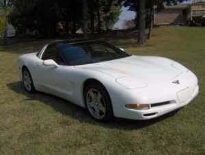

98 corvette 23,000.jpgThank you so much I have had a lot of help on this site . I came on this site just as soon as this problem arose and also about the steering column lock. This is a great site I do like this 98 I think it hadn't been drove very much I am the third owner the previous owner didn't put but about 19,000 thousand miles in the past 12 years. :w
View attachment 4610Thank you so much I have had a lot of help on this site . I came on this site just as soon as this problem arose and also about the steering column lock. This is a great site I do like this 98 I think it hadn't been drove very much I am the third owner the previous owner didn't put but about 19,000 thousand miles in the past 12 years. :w
Well then - it's your DUTY to make up for lost time! Get out there and drive that baby, man! :D
