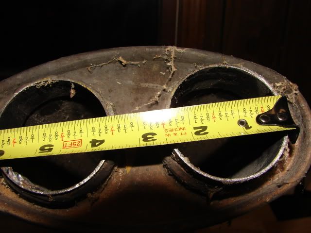

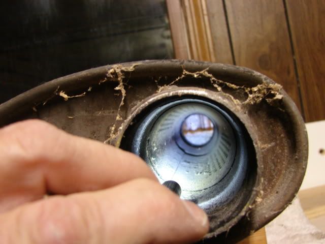

The resonator
http://i285.photobucket.com/albums/ll72/John-68/Resonator012.jpg
http://i285.photobucket.com/albums/ll72/John-68/Resonator002.jpg
The reason I have these pictures is because I removed the resonator and replaced it with straight pipe. $80.00 bucks at local muffler shop. I have been running it this way for about 6 years now. The sound is deeper but not intruding while cruising at 70 plus. I receive a lot of compliments on the sound of the car. If I use the automatic trans. to slow down the car it will pop and bark from the exhaust. I can't say what might be to loud for you but for this 70+old guy it is just right.
