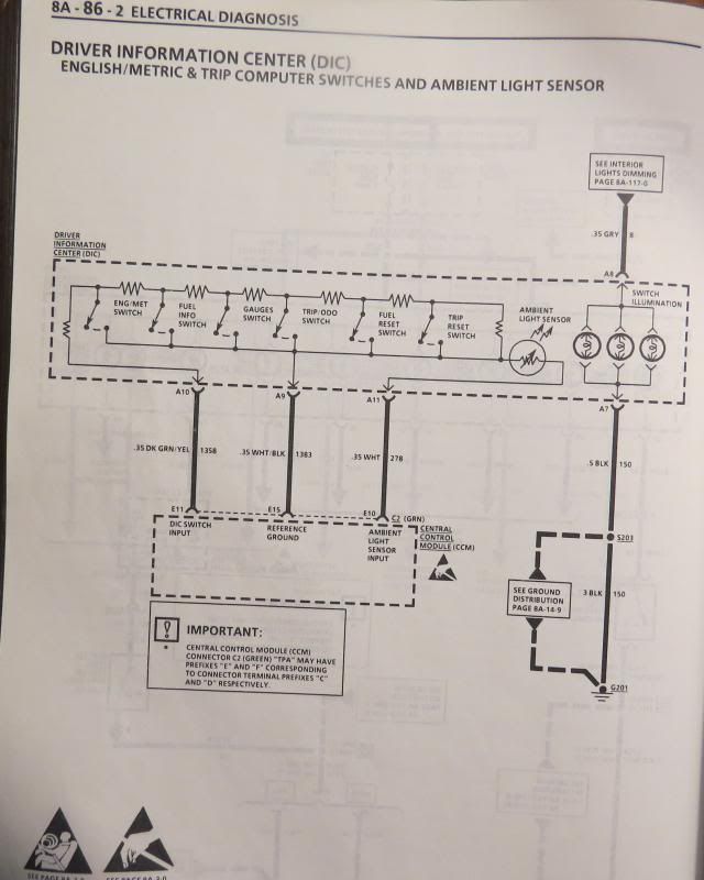

Question regarding the trip odometer/ fuel economy buttons to the left of the driver information center on a 93 C4 Corvette . these buttons do not work on my car. I've replaced the entire driver information center and buttons along with the entire instrument cluster but still nothing . my guess now would be this is an issue within the ECM ??? Your thoughts ? Any help would be appreciated ! Really driving me nuts this doesn't work. I mean it doesn't affect anything and the car runs just fine but it bothers me when something doesn't work !!
