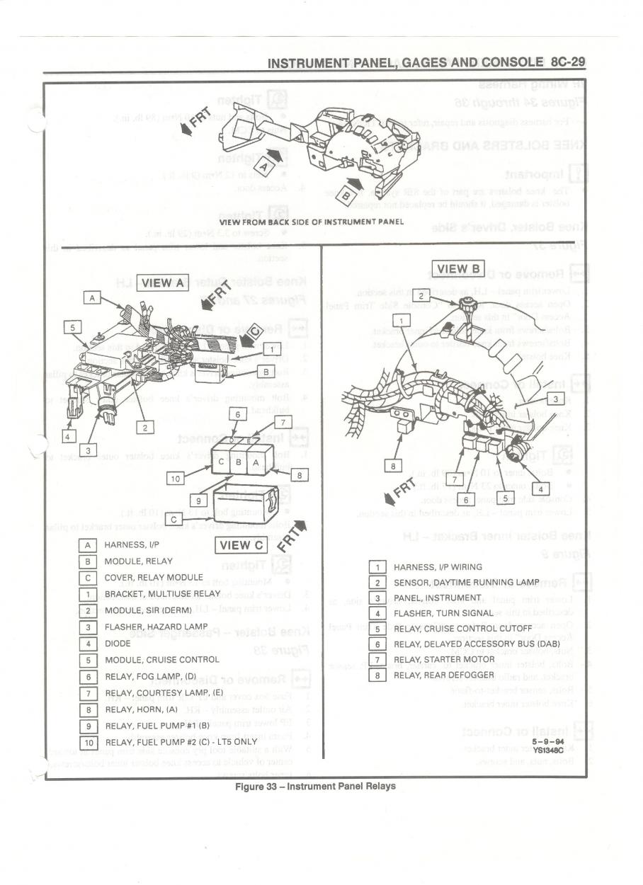

If I remember correctly the fuel pump relay is under the dash on the glove box side. But I don't think that is the problem. Do you have access to a scanner that will give you real time info? The tach dropping to 0 makes it sound like an ignition issue. The turning and cutting out sounds like something shorting out. Under your battery is a wire junction that connects several positive wires to various circuits. Inspect and clean the whole junction. This is an easy thing to do and won't cost anything. If it helps great, if it doesn't then keep us posted.
The location of the fuel pump relay for a 93 is the same as the illustration Rabbit posted. I don't believe it is your problem since power to the pump is also provided on the back up circuit through the oil pressure sending unit, both would need to fail for the relay to cause your problem.
