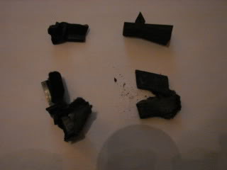

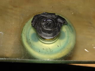

Window problem
There is a peace that is fastened to the window that locates the corner of the window in the track. It is probably broken.
They should be able to remove the window and fix it. The problem may be getting the part.

Just got an update from the body shop. The window regulator appears to have been replaced recently. He said there is a hook on the back part of the window that stops the back of the window from going past its natural stopping point and there looks to be a place for a hook in the front portion of the window. There is no hook there to stop the window from going past its natural stopping point. He is making some calls to try to locate what the part is and were he can get his hands on it so the window regulator will be complete and make it stop once it is closed at the point it is suppose to be to seal properly. I will let you know more when I find out more info.
